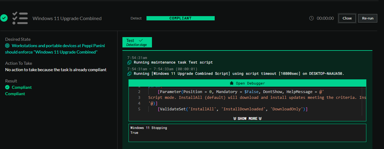

About running this task in Audit mode
Audit mode will only run the test action against the machine. Part of this script is to verify if the computer is already on Windows 11, and to return a true to ImmyBot if it is. With that said, if a computer is Windows 10 and passes all of the tests it will also return a true to ImmyBot.
All of this to say if you run this task against a Windows 11 machine in Audit mode with the expectation that you need to update it to Windows 11, your results will be skewed in the audit.
Only run this task in Audit mode against Windows 10 machines. You can utilize the Windows 10 Filter Script if you don't want to utilize Tags.
We recommend using the Windows 11 Upgrade Task in Audit mode against the computers you're wanting to update. This is to ensure ahead of time that the computers are compatible with the update process.

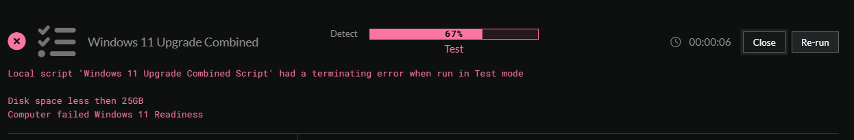

Why does the task fail in the test phase?
- This can be for a number of reasons, but the answer is in the results of the test phase. This task checks for 4 things in the test phase:
- Is this computer already Windows 11? If yes, pass and do nothing else, if no, move on to step 2.
- Disk Space - Is the free space more then 25 GB? If not fail, if is it, move one to step 3
- Disk Health - Are there any predictive or SMART failures on the disk? If yes, fail, if not, move on to step 4
- Windows 11 readiness - Does the computer pass the Windows 11 readiness script from Microsoft? If no, fail, if yes move on to the execution stage.
